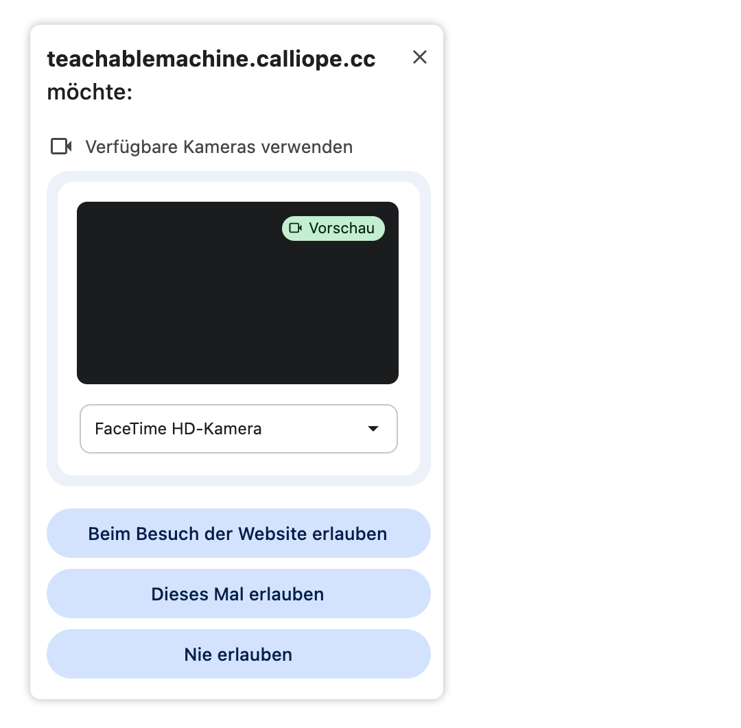

Prepare

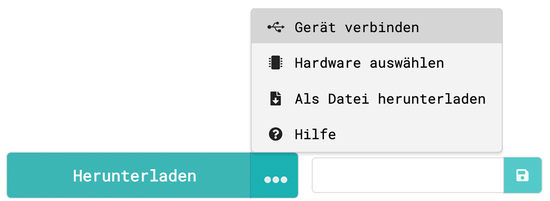

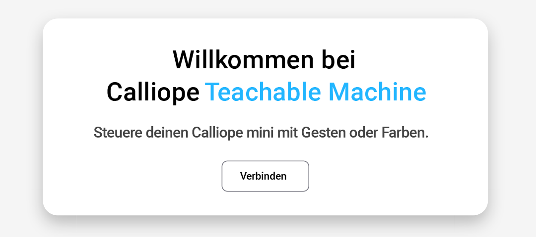

The Calliope mini is connected to the computer via Web-USB and camera settings are defined. makecode.calliope
⚠️ Calliope Teachable Machine requires a browser that supports Web-USB, e.g. Chrome or Edge. makecode.calliope

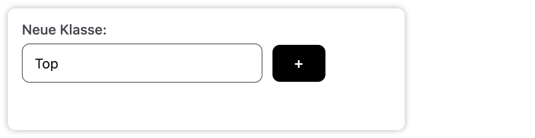

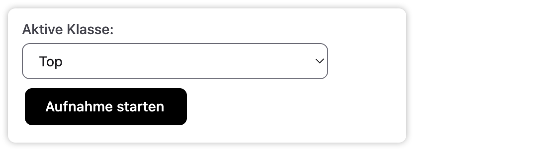

Generate data
In the first step, name a class and save the name. In the next step, add images to this class.
Hold down the button to capture images (10 images/second).
The more images a class has, the better that class can be recognized. There should be at least 60 images per class!
A training model requires at least three classes. These two steps must be repeated for at least two additional classes.

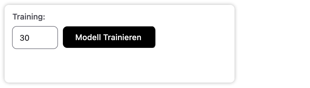

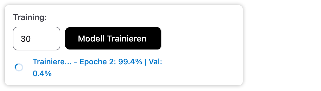

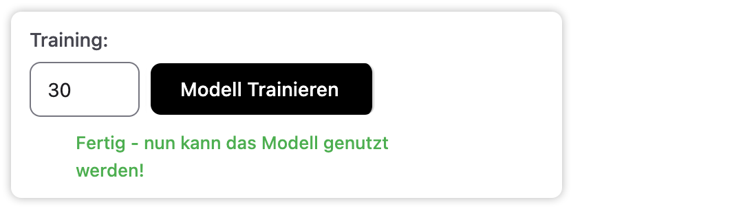

Train the model
Based on the collected data, a model is created that can distinguish between the classes.

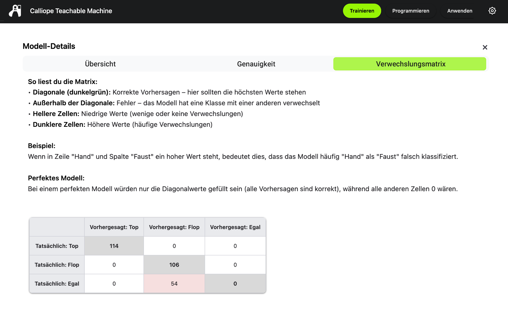

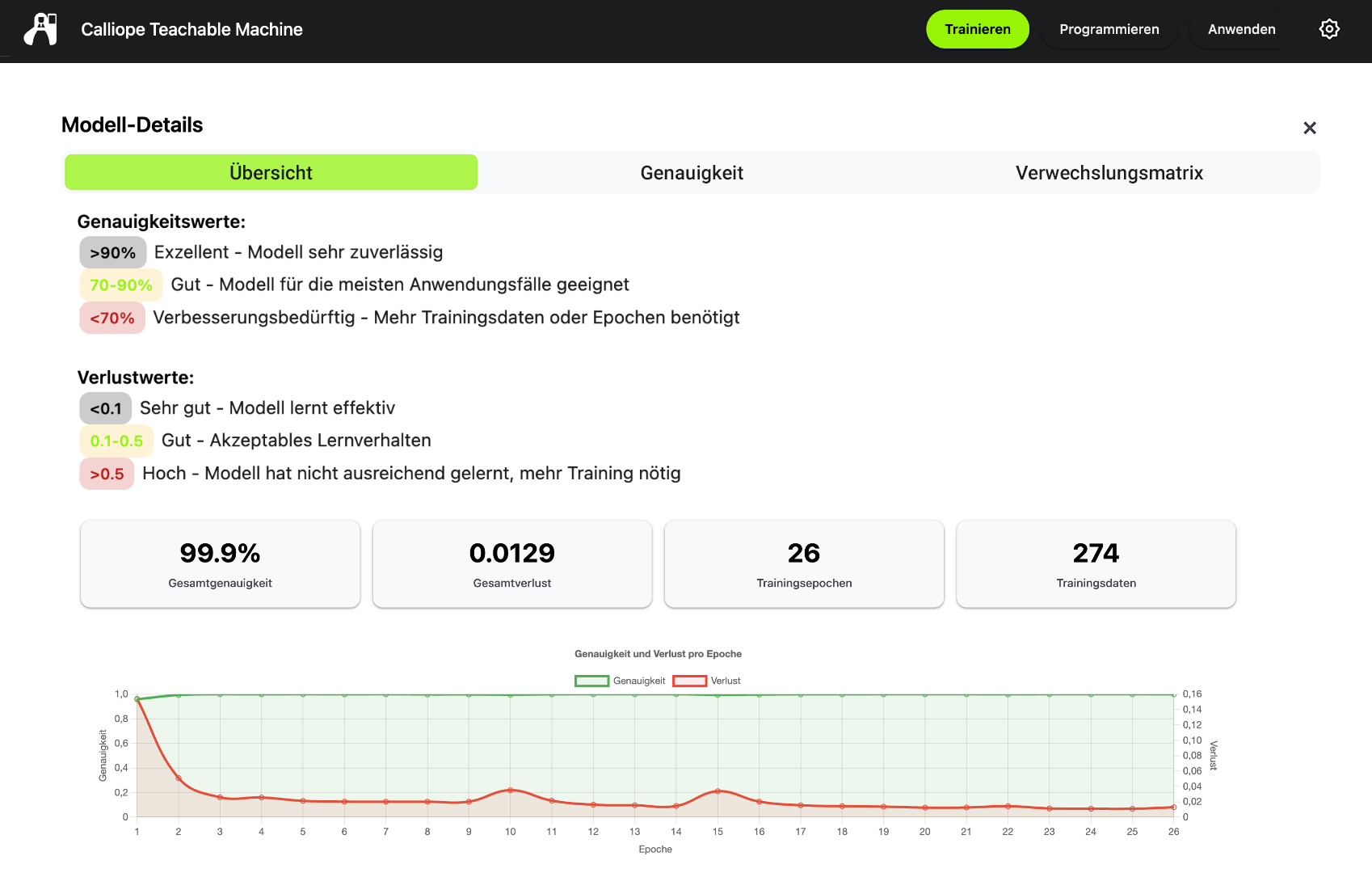

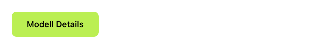

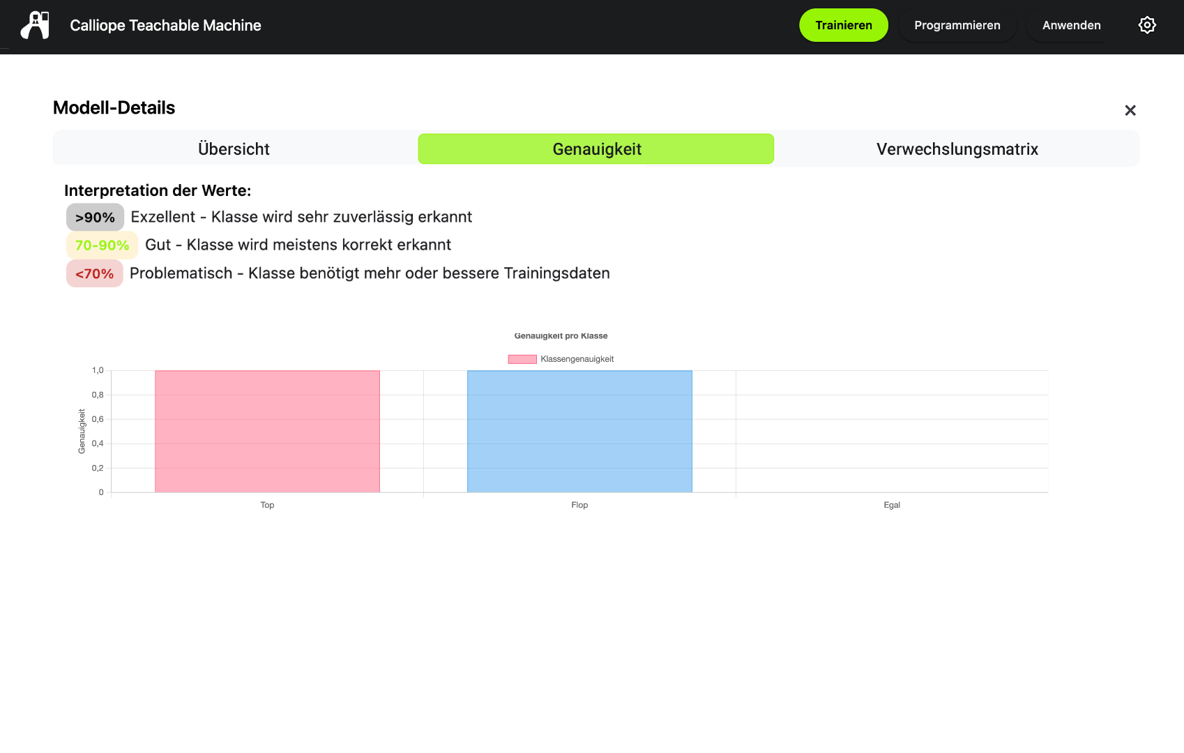

Model details
The model details provide information about accuracy and reliability.

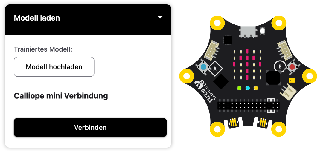

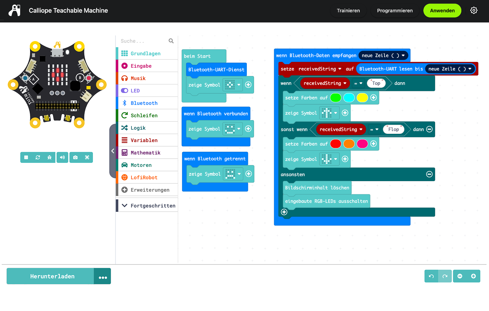

Programming
The model can be processed directly in MakeCode and thus integrated into prototypes with the Calliope mini.
Transfer the program to your Calliope mini via Web-USB so that in the next step you can connect your Calliope mini.

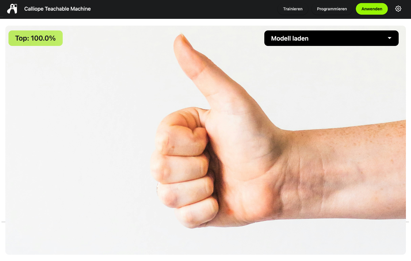

Apply and review the model
The algorithm’s decisions are displayed directly and can therefore be checked and reflected on.
