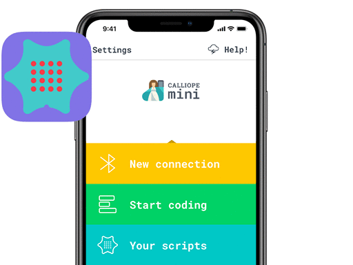

1connect Calliope mini to the app
The program is transmitted via Bluetooth and deletes the previous script, but not the firmware of the mini. The last transferred program is always executed. If the mini is disconnected from the power supply and then switched back on or the reset button is pressed, the last program transferred is deleted and the Calliope mini menu with programs 1-5 is executed.
To establish a connection to send code to Calliope mini from the app, you must follow the steps below:
Prepare Calliope mini
  1. press the A+B and Reset buttons on your keyboard simultaneously
    Calliope mini. Release reset after about 1 second.
  2. After you release reset,
    continue to hold down the A+B keys.
  3. ID Pattern - The Calliope mini automatically displays an
    Pairing icon (five bars) on the LED display.
Connecting Calliope mini to the app
  1. selection - Select the "Select another mini" option.
  2. enter ID - Enter your ID pattern and click Connect
  3. your Calliope mini is now connected. Now you can start programming with the app!
Transfer code from app to Calliope mini
  1. use an editor to create a script or transfer existing programs.
  2. now you can transfer code from the app via Bluetooth.
  3. transfer the code to the Calliope mini with the following instructions: Search mini (this phase may take a few seconds), restart, transfer, transfer successful.
  4. the application now appears on the Calliope mini!
If you use MakeCode for programming, you can define the connection settings yourself. We have set "No connection required" as default. This provides the simplest connection between a device and a Calliope mini. If you are using different devices and you want to change minis, you should finally play the demo program from the app on the mini. This way you can easily connect to the mini with any other device next time. Otherwise the ID pattern will not appear!
Why is pairing important? Well, this pairing is all about the wireless connection between Calliope mini and smartphone/tablet/computer. By connecting the smartphone to the Calliope mini, you can ensure that these devices can communicate with each other.
Quick help for problems with the connection or transfer of the programs can be found here:
