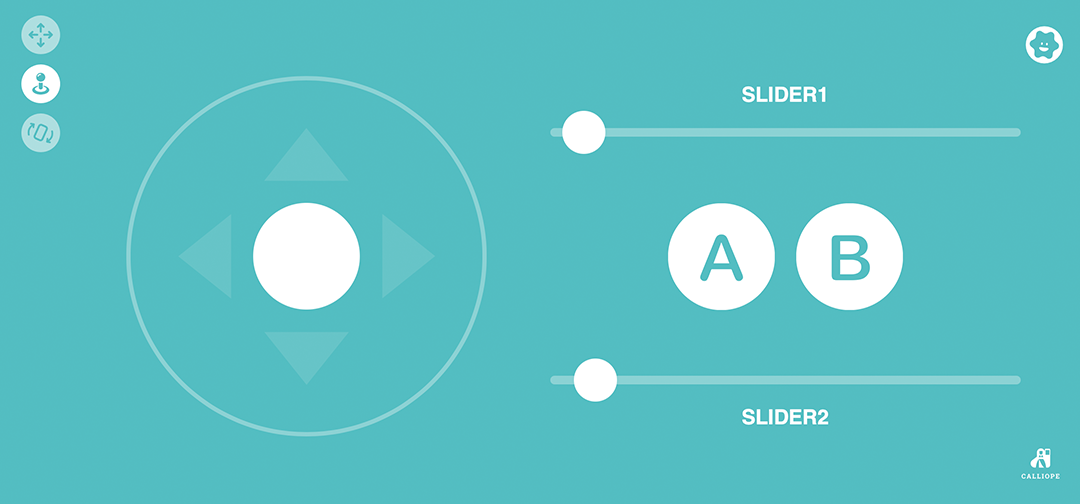

Mode transfer
Arrow keys = "mode_dpad"
Joystick = "mode_analog"
Accelerometer = "mode_accelerometer"

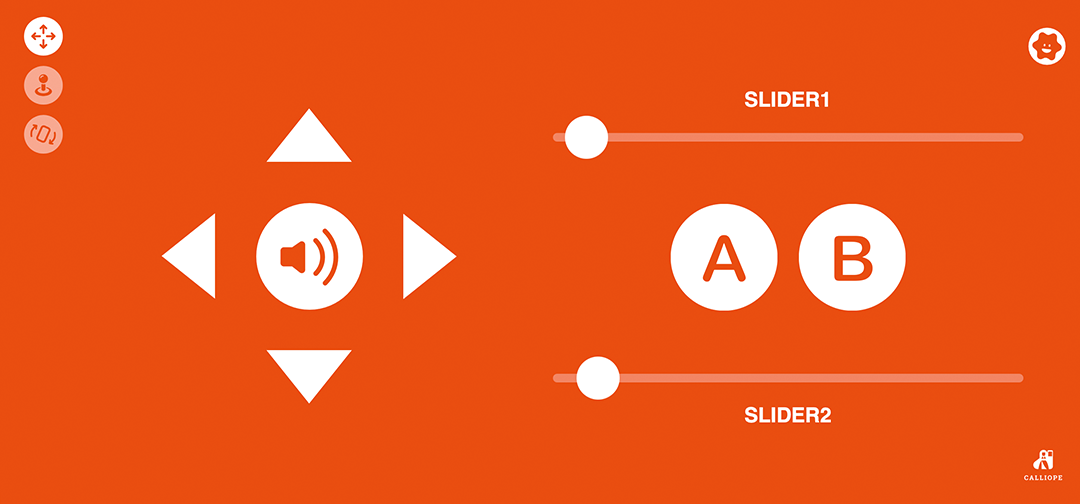

Control via arrow keys
Input in the app Transfer to Calliope mini
Arrow up → "up"
Arrow down → "down"
Arrow left → "left"
Arrow right → "right"
Speaker button → "horn"
Button on release → "stop"
Control via the sliders
Slider 1 → sends the value (0–180), prefixed with the letter “c”, for example: c0, c100, c180
Slider 2 → sends the value (0–180), prefixed with the letter “x”, for example: x0, x100, x180

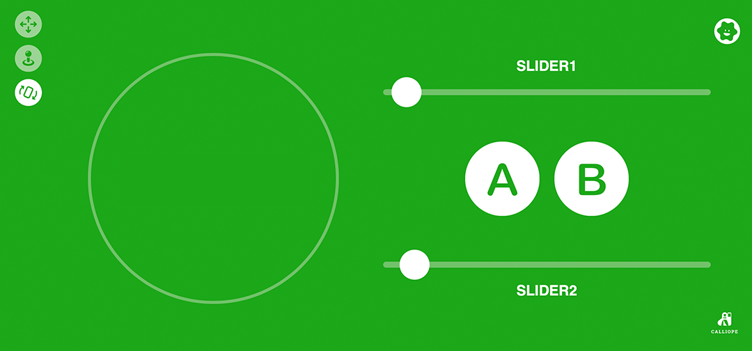

Control via the joystick or the accelerometer
Joystick/Accelerometer → sends values for the X and Y axes (-90 – +90), prefixed with the letter and sign, separated by a comma, e.g.: X-90,Y+05, X+90,Y-05
