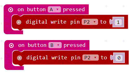

###Code
![](https://calliope.cc/media/pages/projekte/tasten-steuern-das-licht/56803cbc0f-1558479295/tastensteuernlicht01.gif)
Note: A digital value of "1" means that the digital output at the pin will be switched up, i.e. the pin has a voltage of 3V. The value "0" means "no voltage at the pin".

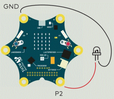

Electronics
LED (+/-)!
- short leg: GND (-)
- long leg: analog output (P2)
![](https://calliope.cc/media/pages/projekte/tasten-steuern-das-licht/20042f9c6a-1558479297/tastensteuernlicht02.gif)
