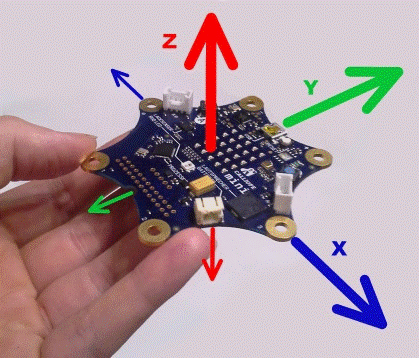

The Calliope mini measures the acceleration, i.e. your jumping, with its accelerometer.
It needs 3 directions: x, y, z.

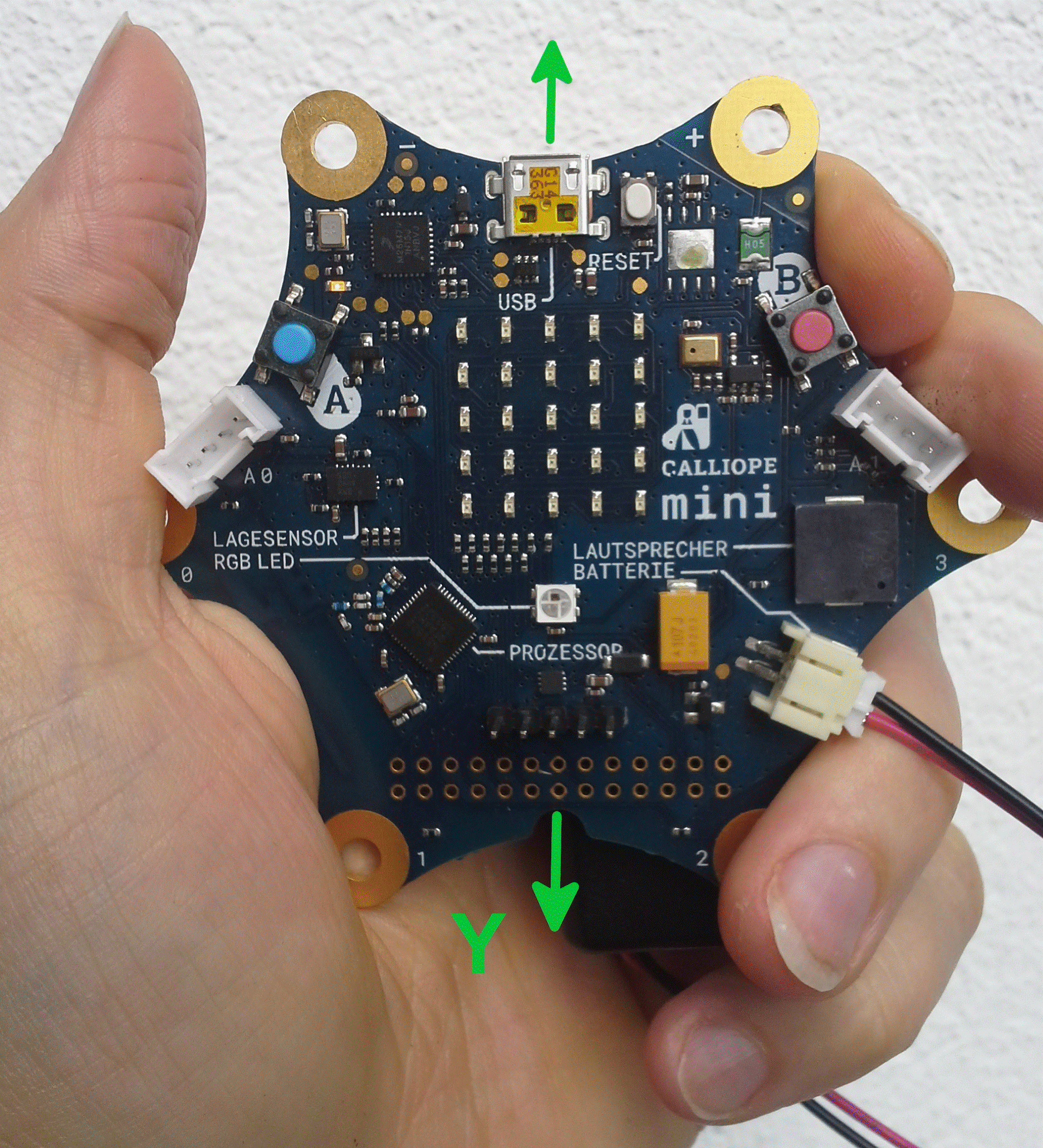

When jumping, it's best to hold the Calliope mini in your hand like this.

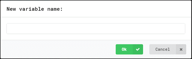

- Click into the white field and write "jumpCounter". This is the new name of the variable.
- Click on OK.

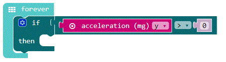

Your program now compares the value the Calliope mini measures when you jump with the value when you don't jump.
- Put the blocks together like this and change “x” to “y” and “<” to “>”:
![](https://calliope.cc/media/pages/projekte/sprungzaehler/7019c12c00-1558479166/sprungzaehler6.gif)

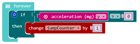

- Get “change item by 1” from Variables.
- Change the word “item” to “jumpCounter”. You can do this by pressing the small arrow in the block and then clicking the word “item”.
Your program should look like this now!
![](https://calliope.cc/media/pages/projekte/sprungzaehler/295a77c33c-1558479167/sprungzaehler7.gif)

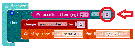

- Put a sound- block behind “then”, under “change jumpCounter”. The Calliope mini should now beep when he counts a jump.
Hmm,...something is wrong! Your Calliope mini beeps all the time, even if you don't jump!
Oh, ...that's the reason: The Calliope mini even counts if you don't jump but just touch it! That's why you have to make this number waaay larger - around 2000 or so ...
![](https://calliope.cc/media/pages/projekte/sprungzaehler/44cb350537-1558479167/sprungzaehler8_5.gif)
