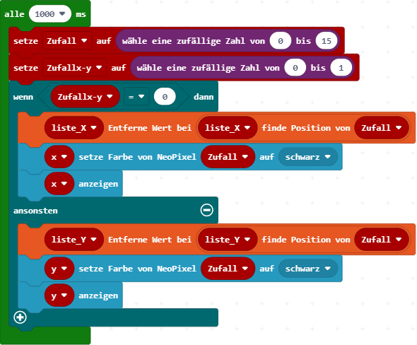

  3. For an increased difficulty level, a random LED is switched off every second.

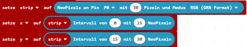

  • The first block determines the length and the connection of the NeoPixel strip.
  • The two “Interval” blocks divide the strip into two areas and enable the division for the x and y directions of rotation.

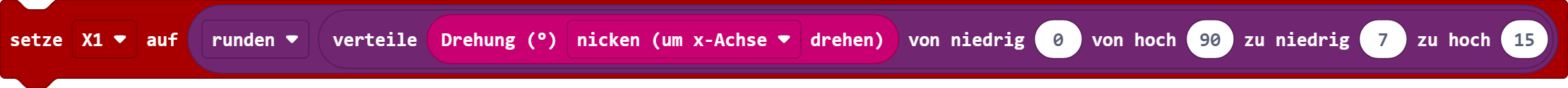

  • The values of the position sensor are distributed over a specific area of the NeoPixel and stored in a variable.
  • For clarity, half is divided again to cover negative (-90° to 0°) and positive (0° to 90°) rotation angles.

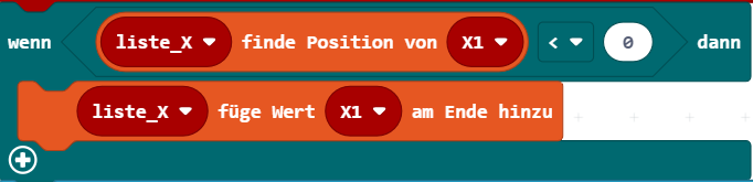

  • The previously saved variable can be saved in a list to determine when all LEDs are switched on.
  • Every second, an LED is switched off to make the game a little more difficult. To do this, a random value is removed from the list and the corresponding LED is switched off.
