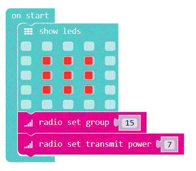

In this example I used the MakeCode Editor popup: yes. The code on the questioner mini is relatively short. As soon as the calliope is started, it sets the radio channel to 15 and the transmission strength to a maximum of 7.
![](https://calliope.cc/media/pages/projekte/fragespiel-per-funk/13995974f1-1558479120/fragespiel1.gif)

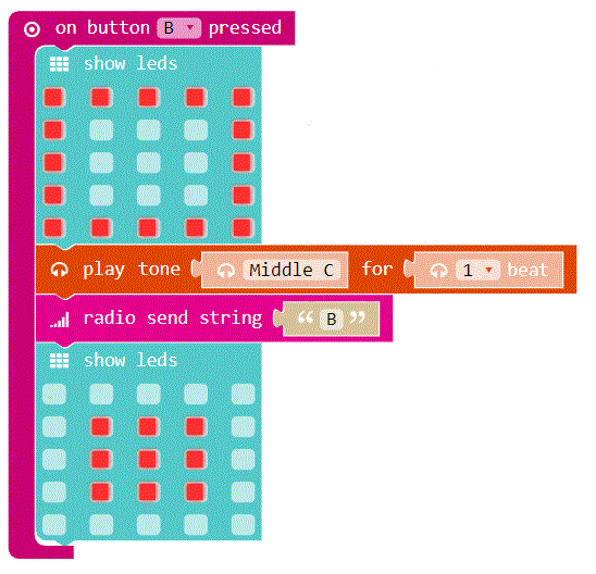

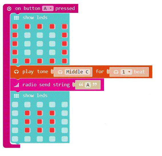

At the start the group and the transmission strength are set. As soon as you press either A or B, the corresponding letter should be sent out:
![](https://calliope.cc/media/pages/projekte/fragespiel-per-funk/df0211d567-1558479120/fragespiel2.gif)
![](https://calliope.cc/media/pages/projekte/fragespiel-per-funk/348a422600-1558479121/fragespiel3.gif)
That's it for the questioner mini or Game Master.

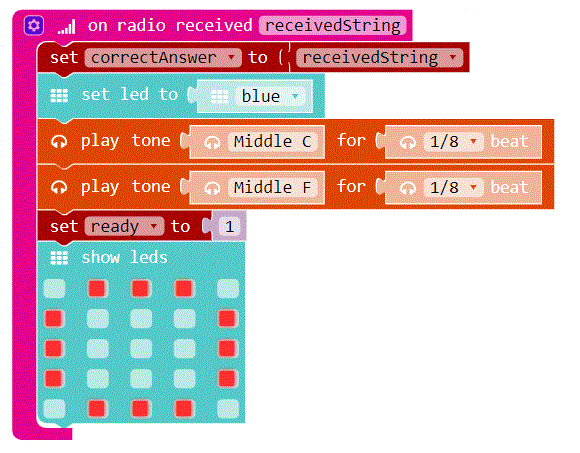

At the start the player mini also sets the receive channel to 15. The player mini has the variables "Ready" and "Correct_Response". In "Ready" it is stored whether the calliope has received a signal for "A" or "B". The correct response is stored in the "Correct_Response" variable.
As soon as a signal is received, the player mini must save the signal and set "Ready" to 1:
![](https://calliope.cc/media/pages/projekte/fragespiel-per-funk/c8d3e3399b-1558479121/fragespiel4.gif)

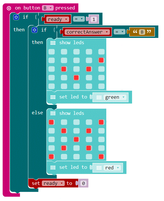

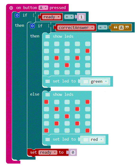

If A or B is pressed now, the first check is whether the player mini is ready (i.e. whether he has already received an answer).
Then, when A is pressed, it is checked whether "A" is the correct answer (and vice versa for B). Subsequently, feedback is returned on the display and the "Ready" variable is reset to 0 (this prevents a player from changing his or her mind):
![](https://calliope.cc/media/pages/projekte/fragespiel-per-funk/4b17e7382c-1558479122/fragespiel5.gif)
![](https://calliope.cc/media/pages/projekte/fragespiel-per-funk/fca93e601c-1558479122/fragespiel6.gif)
