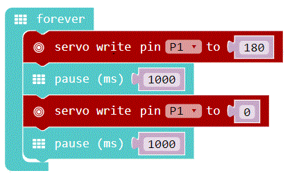

####Connect a servo motor to the Calliope mini. Let it rotate back and forth regularly.
3Solution
###Code
![](https://calliope.cc/media/pages/projekte/einen-servomoter-steuern/b42cca4708-1558479305/servomotor01.gif)

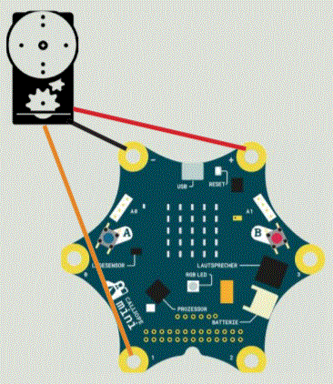

Electronics
red cable - VCC BATT (+)
black/brown cable - GND (-)
yellow/orange cable - analog pin P1
![](https://calliope.cc/media/pages/projekte/einen-servomoter-steuern/170341b45b-1558479306/servomotor02.gif)
