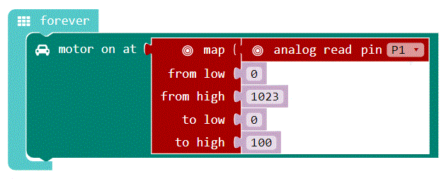

####Connect a potentiometer and a DC motor to the Calliope mini. The speed of the motor is controlled by the potentiometer.
3Solution
###Code
![](https://calliope.cc/media/pages/projekte/einen-dc-motor-steuern/83ab94211a-1558479282/dcmotor01.gif)

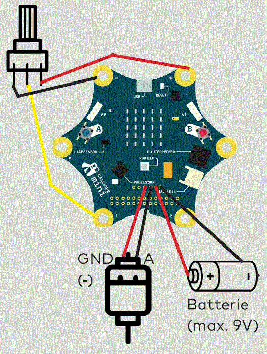

Note: The Calliope mini motor driver is required to control motors. An additional power supply with up to 9V can also be connected there.

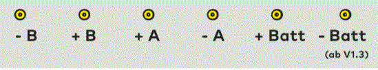

Wiring of the motor pins
