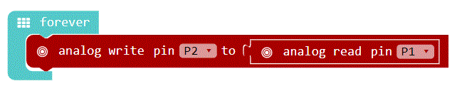

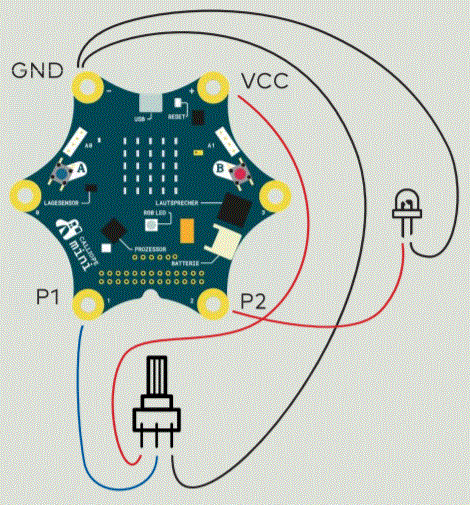

####Clamp an adjustable resistor (potentiometer) and an LED to the Calliope mini. The LED is dimmed by turning the potentiometer.
3Solution
###Code

Electronics
LED (+/-)!
- short leg: GND (-)
- long leg: analog output (P2)
potentiometer
- outer leg: GND (-)
- middle leg: analog intput (P1)
- outer leg: VCC (+)
