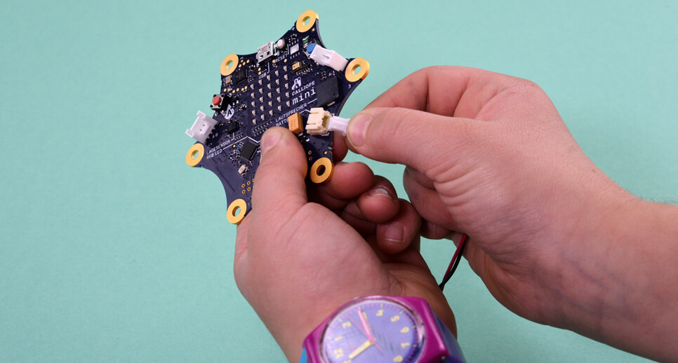

Here are the instructions on how to connect the battery pack to your Calliope mini:
The supplied battery pack requires two AAA batteries.

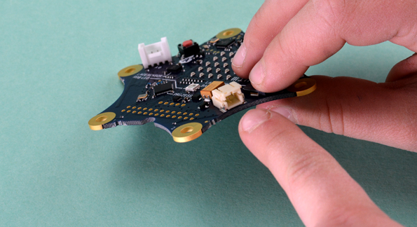

Carefully insert the small white plastic connector (JST connector) from the battery pack into the board’s battery socket.
Be careful to insure that the ridge on the plug is facing upwards.
If the plug slides easily into the socket then you are attaching it correctly. Otherwise, turn the plug round and re-insert it into the socket.
