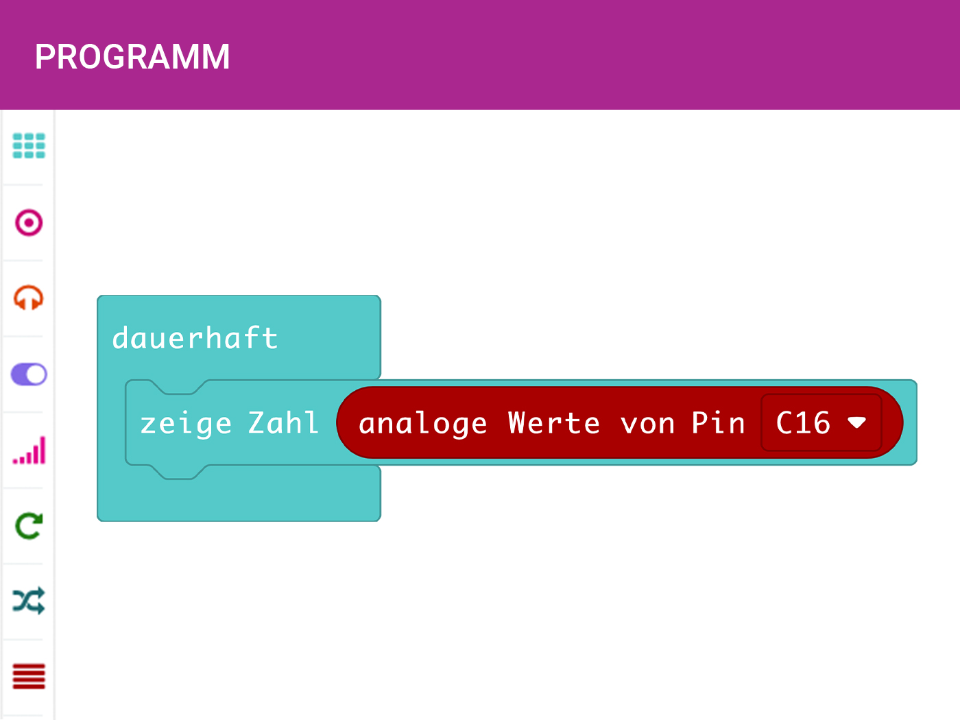

Makecode
To work with the values of the humidity sensor, the respective value of the pin on which the sensor sends the data must be queried. In this case this is pin C16.
To get the current value shown on the LED display, the block "show number 0" from the "Basics" category can be used. To see the values of the sensor there, we need the right block from the "Pins" category.
The individual pin blocks can be found under the "Advanced" category. There the block "analog values of pin P0" must be selected and "P0" must be changed to "C16". This block is inserted instead of the "0" in the "show number" block.
