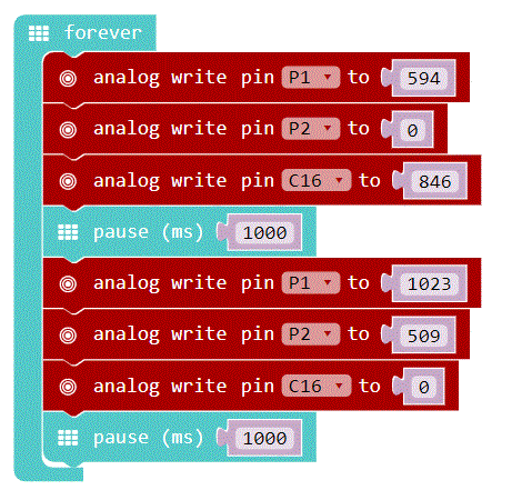

####Connect an RGB LED to the Calliope mini. Display the colors of the rainbow one after the other.
3Solution
###Code
Here is a code example with two colors. For more colors just copy blocks and paste values.
![](https://calliope.cc/media/pages/projekte/farben-des-regenbogens/136e9a7579-1558479290/regenbogenfarben01.gif)
Note: These are the 10-bit values of the rainbow.

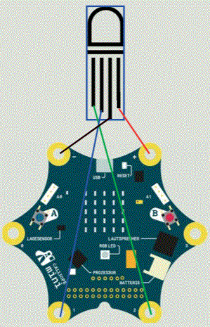

Electronics
RGB-LED
- kürzestes Bein (grün): analog output (P2)
- longest leg (black): GND (-)
- leg next to green (blue): analog output (P1)
- outer leg (red): analog output (P16)
