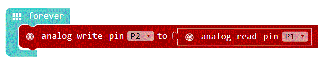

Code
![](https://calliope.cc/media/pages/projekte/einen-vibrationsmotor-steuern/2ee985c8a2-1558479302/vibrationsmotor01.gif)
Note: A dimmed LED and a vibration motor are both analog outputs. Therefore the code is exactly the same as in the challenge "Dimming a light".

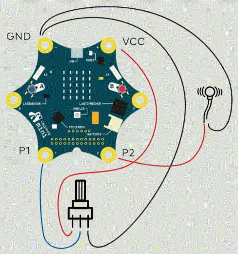

Electronics
- vibration motor (+/-)!
- black cable: GND (-)
- red cable: analog output (P2)
potentiometer
- outer leg: GND (-)
- middle leg: analog intput (P1)
- outer leg: VCC (+)
![](https://calliope.cc/media/pages/projekte/einen-vibrationsmotor-steuern/82e8a5ca5e-1558479304/vibrationsmotor02.gif)
